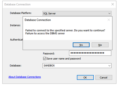

Hello
After updating ArcPro to 3.0 and update .Net to 6.0.3, I can't connect to database in ArcCatalog anymore?
Tags (3)
George_Thompson
Esri Notable Contributor
you may need to re-install the SQL Server ODBC driver.
What is the error message?
--- George T.
anonymous55
Thanks for replay
which version of SQL Server ODBC driver?
George_Thompson
You can download it from My Esri: https://pro.arcgis.com/en/pro-app/latest/help/data/geodatabases/manage-sql-server/connect-sqlserver.... or Microsoft: https://docs.microsoft.com/en-us/sql/connect/odbc/microsoft-odbc-driver-for-sql-server?view=sql-serv...
It is backwards compatible. Close ArcGIS Pro before installation, install driver, open ArcGIS Pro, and retest.
