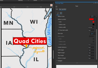

Is there a way in Pro to adjust where a balloon text graphic's dart/leader hits the label? I can change where it points with ease, but I can't find a way to modify where the width of it hits the label.

The problem is the callout is where I want it and the margins are where I want them; I only need to change the stem.

No, you can move where the leader points and the callout, but it decides how to draw the stem. Seems to switch from a left side and a right side position based on proximity with no further options for adjustment. It looks like I'll need to pop it into Illustrator.

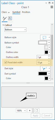

WendyHarrison
Hi @wayfaringrob
at this point there isn't fine grained control over how the callout attaches to the label.  This would be something good to create a post for over in ArcGIS ideas.
Right now you can control the width of the dart and if it is fixed or not.
