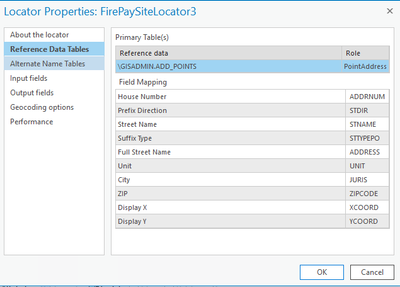

Reference Data Table:

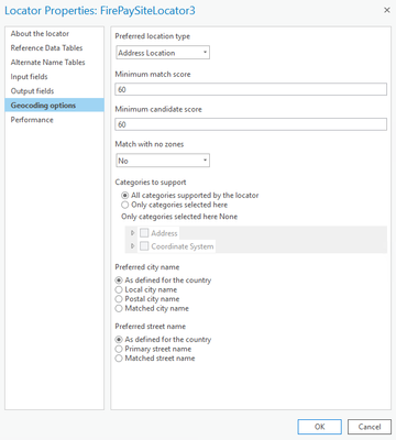

Geocoding Options:

@JoshBillings The locator you created is with zones (city, zip) and the 'Match with no zones' setting is set to "No", which means you need to provide a zone or location when entering an address when the service is not used with a map. When using the service with it's current settings via the REST endpoint requires that you include a zone or use the location parameter to get results returned. The locator works as expected in ArcGIS Pro because the center of the map is being used as the location or zone when entering the address w/o city or zip, but you should also get suggestions as you type the address in the Locate pane in ArcGIS Pro. We have made improvements to the way the locator behaves when built with zone and 'Match with no zones' is set to "Yes" in ArcGIS Pro 3.1and Enterprise 11.1. Patches exist for Enterprise 11.0 and the latest ArcGIS Pro 3.0.x patch. Enterprise 10.9.1 is the last version that supports publishing classic locators created by the Create Address Locator tool.
