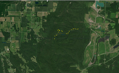

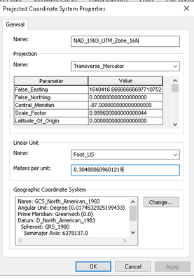

You say ArcMap even though you posted in Pro.  In ArcMap, if I set the coordinate system to UTM 16N Feet,
then do the Display xy data, this is where they map to.
