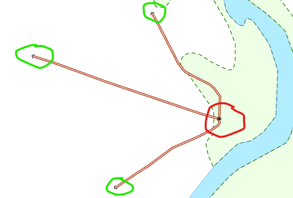

I am working with Road layer and I need to put arrows on the end points of road, like this:
I am adding Shape Marker at extremities of polyline and it is the easiest part.
Sometimes I have to merge roads (because they have the same ID) in the middle of one for roads. In this case the road should have 3 endpoints and I need to put arrows on these.
The problem is that it puts arrows on the merge point, but I do not need it there and can't find how to remove these arrows from the merge point.
Anyone could help me with this please?

BrianMoT
Thank you Dan,
it seems that it is not the problem of overlap, I have tried different styles also. I do not need any symbol on the vertex where polylines are merged. I need arrows on the endpoints only and I do not have idea why it puts arrows on the merging point.
