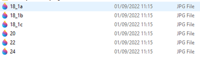

First I need to use Generate Match Table to create the match table, and am struggling to create a photo path for multiple attachments. My working folder has photos 18_1a, 18_1b, and 18_1c and my matching field is 18. This path works when there is a single "18" named photo, but the rest of the photos do not get picked up. How do I name these so the tool recognizes multiple attachments for my singular "18" point?

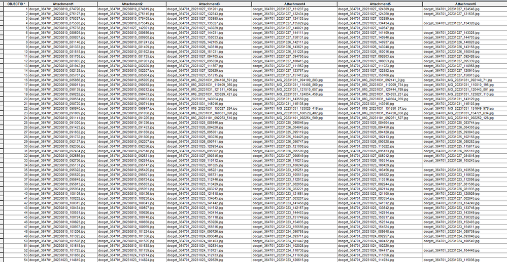

Thanks for taking the time to answer everyone's questions. I have a layer that has multiple photos taken of a location with individual attachment columns. Please see below
The photos are all in a file location outside the gdb. I've enabled attachments. I've tried to create a match table but each time it only shows the headers and no rows underneath.

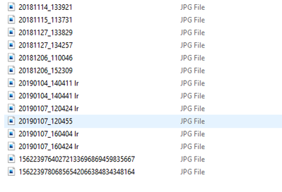

Hi @JohannesLindner
I've attached :
  • an image of the data fields
  • screenshot of the photos which correspond to the field 'name'
  • a screenshot of the attribute table of the layer - not all fields are visible because there are a lot.

I'm not quite sure what you're doing here... This seem to be either a modified attachment table or the attachment table joined to the feature class. And now you want to add new attachments based on the name of the attachments that are already present?
Anyway, the original script matches files whose names (without extension) match the key field value or start with that value followed by an underscore. Your name field includes the extension, so the script doesn't find any matching files.

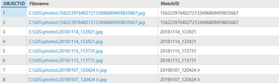

Thank you. I tried it a different way and stripped the 'name' field of the file extension before running your script again. It still did not output a table with records. I've attached a screenshot of the error.
However, I've realised that if I change the field type of the 'MatchID' to text that I do output a table with the filenames and as in the screenshot. The 'MatchID' field then brings across the 'name' into the 'MatchID' field instead of a count of the matches. So I'm not sure what is going wrong here.
Yes you are right about my table looking like a join of the feature layer and an attachment layer. This is because I have buffered a point layer to get a polygon feature class, but the operation does not support attachments. I used a script to export the attachments into the 'photo's folder from the point layer. I joined the attachment table to the polygon feature layer table to keep the details of each row in the table to each photo name in the folder because each row  might have more than one attachment. Perhaps there is a better way? I could start a new thread on this. It seems very close though now, if I can adapt your script to work, then I will be able to match the attachments back to my feature layer.
