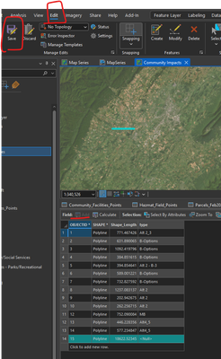

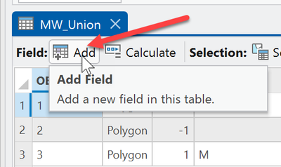

JamesPoeschel
Sounds like you might have edits that weren't saved yet.
The Add button to add a new field gets greyed out after editing the table or adding a new feature. Here I added a new feature and did not yet press save in the edit tab: My Add button is grey.  After pressing save or discard, the Add button becomes clickable again:

KilianSchulze
Thank you very much. this was absolutely the case and now it works perfectly.
