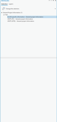

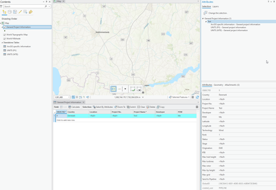

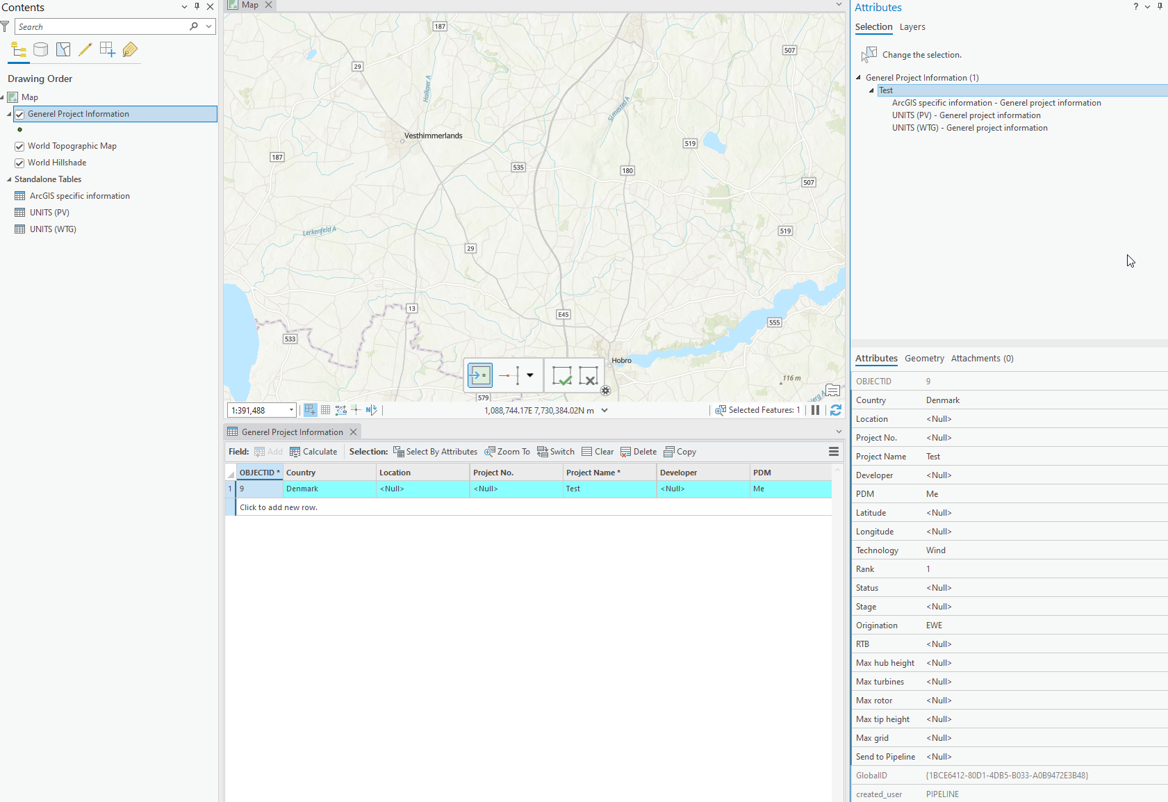

However, when I try to do this workflow in ArcGIS Pro, the "attribues tool" is empty for all the related tables. This is how it looks for the Feature Class.
And this is how it looks for the Relationship class Tables:
The fields of the tables are not even shown..?!? My idea was to be able to continue adding data in these tables. I have tried publishing the layers to our Portal and opening the web map and edit it there, but again it is like the relation between the layers is not taking effect. I can see the relation, but not add data right away.

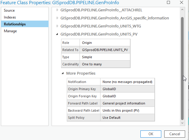

@LarsElmkær_Chwastek
The first screenshot shows the Origin Foreign Key is a GlobalID. Seems like it should be a GUID and not a GlobalID. This article explains how to set it up: https://support.esri.com/en/technical-article/000028010
LarsElmkær_Chwastek
Hi Scott,
Thank you for your answer. 🙂
I actually tried following the steps in the article the first time, but since I want Sync capability and therefor needed versioning, it came back with a lot of errors when trying to publish to our Portal. They seemed to disappear when i changed them both to Global ID's.
But I will give it another shot with the GUID, and see if I've done something wrong the first time. 🙂
