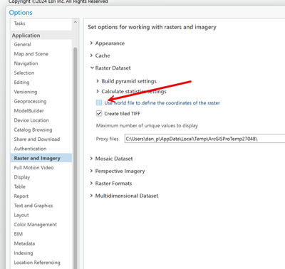

Try Project Options, Raster, and toggle on the world file option

I toggled that setting on already and it does not seem to change anything.
