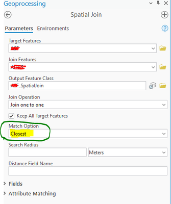

Bryan_bsc
Hi Luca,
Unless your point features are exactly on the line features they won't intersect. I would try changing the match option from INTERSECT to CLOSEST. eg.
Cheers,
Bryan
