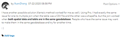

Ed_
by MVP Regular Contributor
Oh wait since you have both the datasets in the same GDB you can simply do a one to many table join. For more reference please see
ArcGIS Pro Join One to Many Join by Attribute
