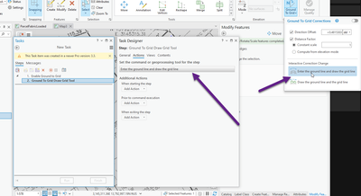

Hello @CameronLacelle ,
I did some testing and here are some ways you can incorporate Ground to Grid in Tasks.
I noticed that when I recorded the Ground to Grid command as a step it basically just reacted as toggle to turn on/off Ground to Grid.  However, if I recorded the the button in the Ground to Grid window I was able to call that tool to draw the grid line.
So after recording that I had a step that when I pressed RUN the Ground to Grid heads up display appeared where I can start computing the Ground to Grid based drawing a grid line.
I do understand that it would also be good to have this a toggle option on a step by step basis.  Because I did notice that recording the Ground to Grid tool in step one, if the tool was already on it would turn it off. THere's no way to say turn G2G on or turn G2G off.  It's a simple toggle.
We will look into enhancing this for a future release.
Let me know if the steps above are helpful.
Thanks!

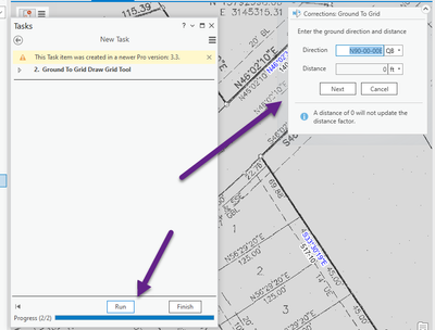

JasonCamerano
Esri Contributor
Oh I did notice one other thing, if I record a step that just calls the Interactive tool (like I did in the 2nd step above) and G2G is OFF.  If I run that step and calculate the Ground to Grid Direction offset and distance factor by the grid line then it will automatically turn ON G2G.  So in theory you can just record that command and the tool will always be on.

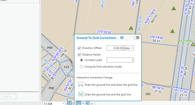

GeoffShort2
Thanks for this info, I can search just for this.
I have slightly different requirements here, I'm not sure I'll be able to do it with a step.
The only thing I need to do is change the Distance Factor "Constant Scale". So I basically just want the for in the bottom menu to show. Do you know if this is possible?
