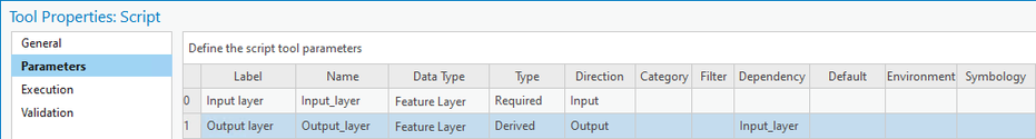

Hi @NickMiddleton ,
Thanks for the question! The preferred way of adding charts to an output layer or table in a tool is to set the  `charts` property of the output parameter (see the following documentation for more information).
To illustrate, I've created a simple script tool with the following parameters:
And the following tool code creates a new chart and adds it to the derived output layer by setting the `charts` property:
import arcpy
# capture the derived output layer parameter
output = arcpy.GetParameterInfo()[1]
# create the chart
chart = arcpy.charts.Bar(x='neighbourhood_group', aggregation='count')
# add chart to the output layer by setting the `charts` property on the parameter
output.charts = [chart]
I hope this helps, but please feel free to reach out if you have any additional questions.
