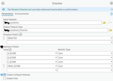

Do you have the data as a feature class?
I hope you have Added the "Final_Score" Field, and Calculated the field with the expression that you mentioned.
Then, you could use Dissolve tool, as mentioned below
Think Location
SarahHartholt

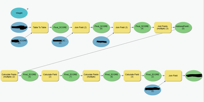

It sounds like the dissolve tool would work but my data is stored in a series of tables, not feature classes, so I'm not sure if it will work.
My workaround for now has been to export one of the tables into a new table (Final_SCORE), join the score field from each of the other tables (2 joins) and then run a series of calculations to get my final score. I would like to slim it down if possible though since I will be adding more factors in the near future.
