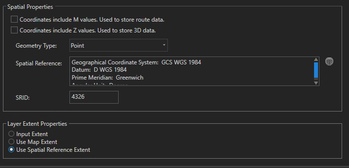

In ArcMap 10.5.1, the Catalog does show the proper Point icon for points which is better than an empty icon in ArcGIS Pro 2.4.2.Right-clicking the view, either in ArcMap or ArcGIS Pro, both describes the views correctly as:
However, the "Let ArcGIS Pro discover spatial properties for the layer" does not seem to work. However, if you leave the spatial field in the Query box and select "Define spatial properties for the layer", it does Validate and in the Next section, it is possible to specify Spatial Properties manually (it is not greyed out) as Point with proper CRS and thus use the spatial field from the Query.
But unfortunately, it ends up with the following error
Not nice!
It probably becomes an ESRI issue to fix...
