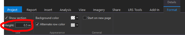

So I figured it out.
In the report Contents, select the Details element.
In the ribbon, choose Format.  This tab has an option to set the Height.  This will set the height of each row of data.
