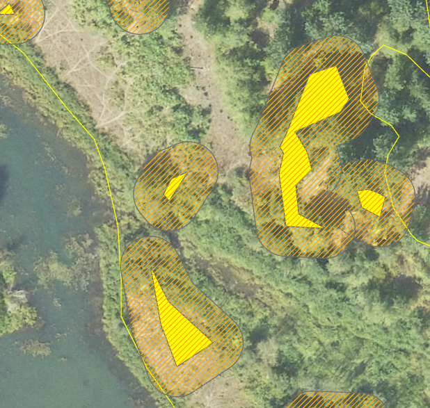

Below you can see I've applied a 25 foot buffer to my geospatial data. I'm trying to calculate the acres of noxious weeds treated within a given area. I have many overlapping polygons due to the buffer. The buffer models the plant's rhizomes extending beneath the soil, so its an important feature for my dataset. How can I accurately calculate acres treated with all my overlapping buffered polygons? Is there a tool I can apply to all my overlapping polygons at once? And how would I go about doing that?
Thank you for your time and support!

Also, I am unclear - do you need to itemize per rhizome buffer as with Dan's response, or just a single acreage for the total area?  My interpretation of your question is that the buffers overlap, and that all you need is the total area of a dissolved buffer.  If that's the case, it's much easier.

Yes, if the buffer dissolved into a total area, that would meet my needs. A single acreage as you put it.
When I create a dissolved buffer, many of my buffered polygons still overlap with other buffered polygons. Currently when I go to calculate my total acres, it is counting the overlapping space twice. I'm working to provide a total acres metric for a grant. I am open to ideas!
