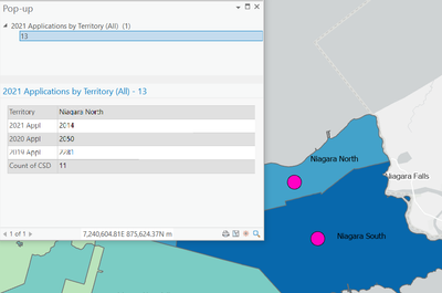

Hi Dave. Thanks for responding. The first picture is of the polygon click (no where near the pink bubble):

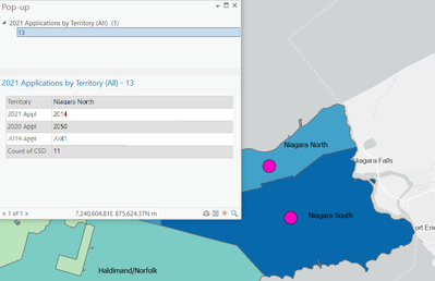

The second picture is of the click on the pink bubble:
There doesn't appear to be any 'next record' indicators. Also, I noticed when I click the bubble, it highlights it briefly then jumps to highlighting the territory (??)
