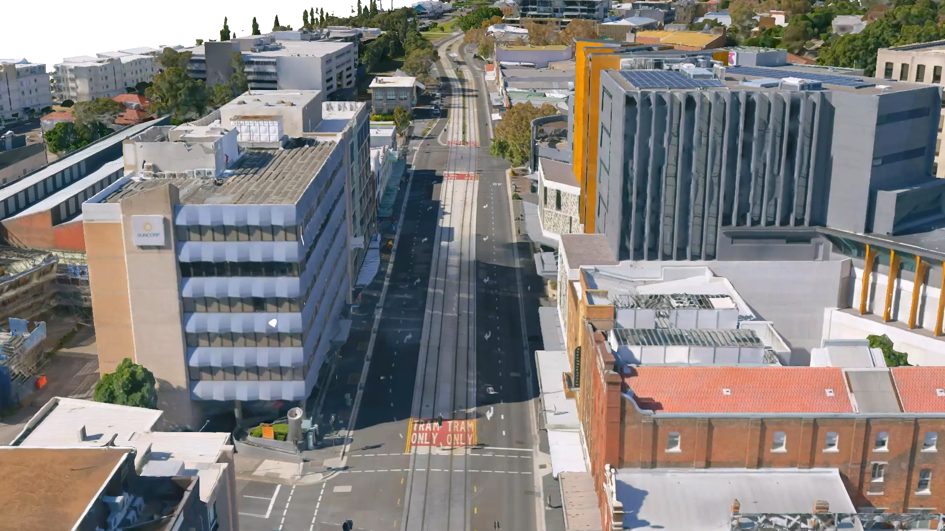

Frame from Existing machine(Compression On)
Frame From New Machine(Compression On)

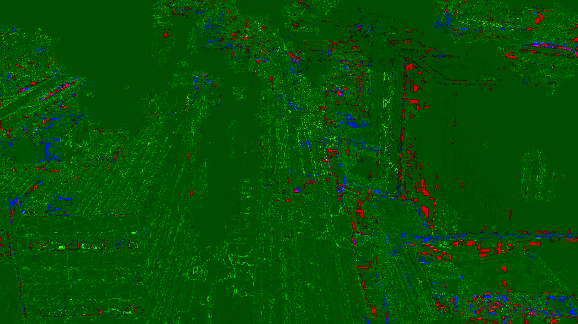

So i did some further research the video files were different in size so I ran a comparison of the videos in FFMPEG using xor filter showing frame by frame there is differences:

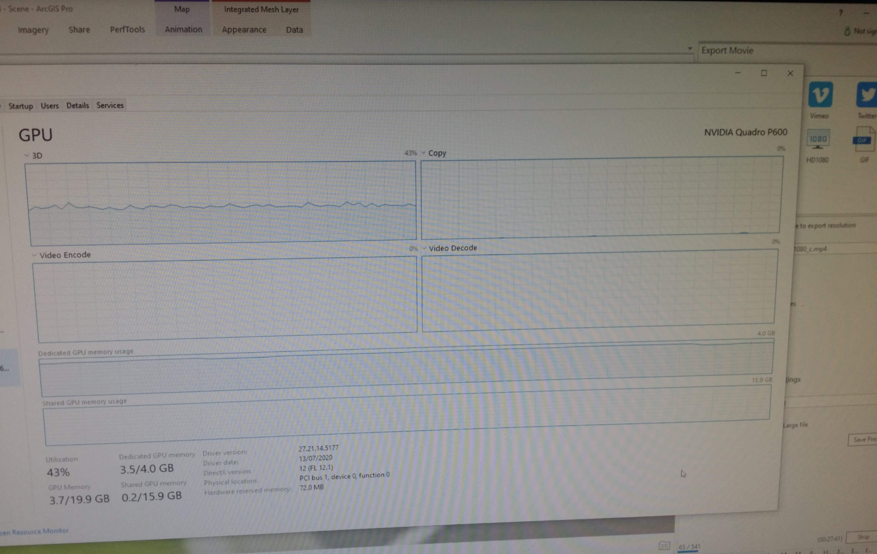

Task Manager Old Machine Quadro P600 (No Texture compression export time 25mins)

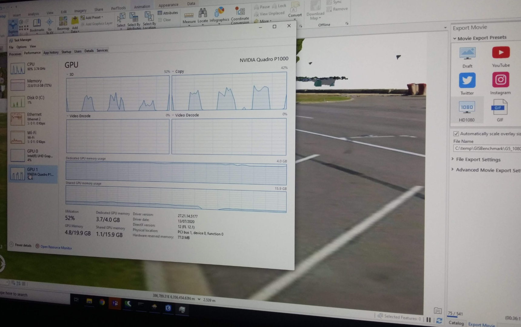

Task manager New Machine Quadro P1000(No Texture compression Export time 35 mins)(note the spikes in GPU copy here that are missing on the P600)
