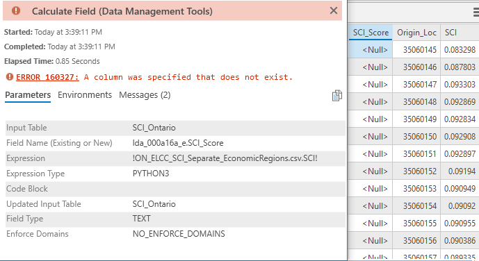

2. Then I thought, ok maybe I can create a new field in the selected layer, and update it with the information from the csv table. I get the message below saying the column specified does not exist!! Well, I am updating SCI_Score column based on SCI column coming from the csv table; both columns have Double type. They are clearly both there in the joined up layer.

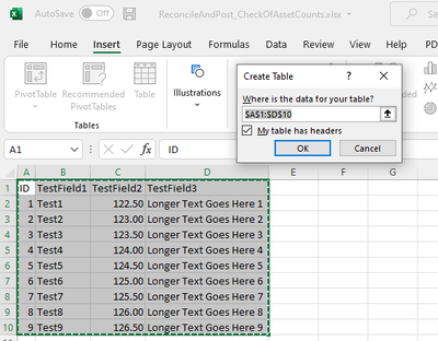

Could it be that someone has the CSV file open, or even may have edited it?  If not I'm not sure why it doesn't work (I just tested it and it worked for me), but I have seen similar messages in the past.  What might work is:
1) open the csv in excel
2) convert the columns into the data types you want (I.E. make sure number fields are formatted as numbers with the correct number of decimals).
3) Select all the rows in excel and click "Table" on the Insert tab (the selected rows will turn into alternating blue and white rows):
4) Save the Excel
5) Import the data into a file geodatabase as a table (using Table to Table tool) and try you're "relate > export" or "relate > calculate" again.
You could probably skip all the Excel steps and just load your data directly into a table using Pro and Table to Table using the .csv file, but formatting the data has worked for me in the past (depending on how complex it is).
I have found that ArcGIS prefers your data in a nice predictable table format, whereas .csv and Excel can be less than predictable (I.E. can be open in other programs, could have numbers and text stored in the same column, stuff like that).

You say all the fields are double, but it looks like your attached image says SCI_Score is Text.
I have found that ArcMap and ArcPro don't honor the data type set in Excel.  They will look at the value in the first row below the column headers (row 2) and whatever type of value is in the field is what ArcGIS assumes the data to be.  So, make sure ALL columns on the second row are populated with something as blanks are set to type Text.
