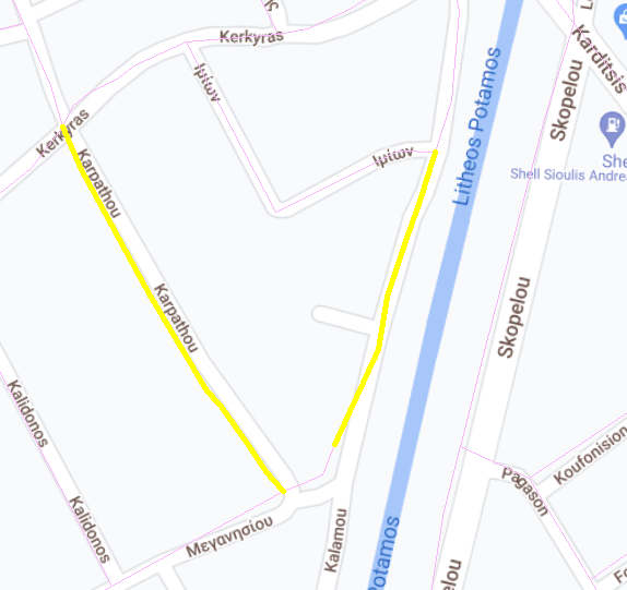

We are moving slowly from ArcMap to ArcGIS Pro. For test purposes we tried to build a network dataset, with basic settings (no cost attributes except for Length, no restrictions, no descriptors).
Error details are at the attached txt file.
Can anyone "translate" the errors?

You have some multipart lines,  try the MultiPart to Singlepart tool to correct this one

Can you give me a possible explanation how multiparts are created? My collegue claims that is a topology bug (created when using topology error inspector).
