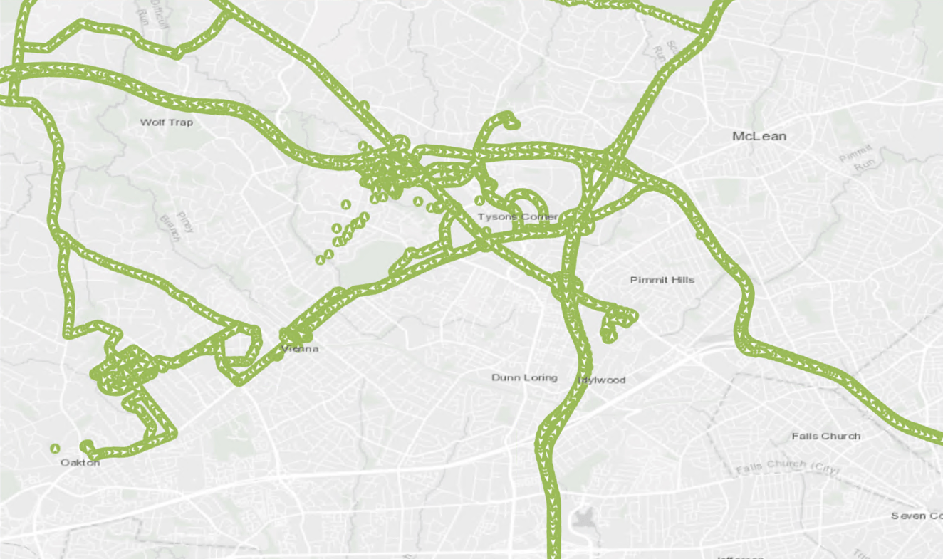

Movement data is defined as anything that consists of simple point features, with a date-time and some sort of unique identifier for the point assigning it to a track or device. Often movement data can be organized into point tracks, which are collections of movement data from the same device. When thinking of movement data, think of data that you would see coming from a GPS. This data can come in a variety of source formats, from things like Comma-Separated Value (CSV) files, GPS Exchange File (GPX), shapefiles, Keyhole Markup Language (KML) files, or a myriad of Internet of Things data endpoints. Normally, these files can contain from a few thousand to millions of records per file.  This data can come from cell phone applications like Tracker for ArcGIS, mobile location data, smart watch applications, to things like ankle monitors for criminals and parolees.

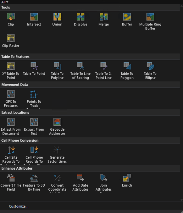

When you are ready to start analyzing your movement data a few steps need to occur prior to running the tools.  Firstyou need to import the data.  If the data is in a shapefile, you canadd that to your map and set your time field.  Otherwise, if the data is stored in a CSV, KML, GPX or any other type of file, you will need to convert the file with one of the following tools:
  • XY Table to Point (for importing CSV or Excel)
  • GPX To Features (GPX files)
  • Cell Site Records To Feature Class
All of these tools are easily accessible in the Data Tools gallery in ArcGIS Pro Intelligence along with a host of other data import tools from the Defense Tools toolbox and Crime Analysis And Safety Tools toolbox.

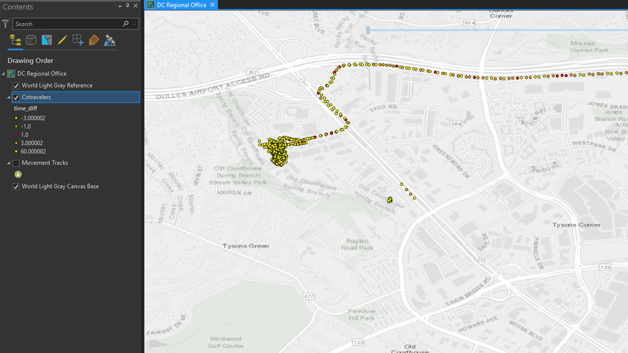

Each of the Movement Tools outputs data in unique ways.  For instance, the Find Cotravelers tool will return to you who the traveler and cotraveler were, their difference of distance and time, as well as the location of the traveling feature.  The geometry for the feature represents the location of the cotraveler at the time that cotraveling was detected.
