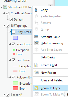

JenniferCadkin
Right click on the Dirty Area layer in the Topology group layer and choose 'Zoom To Layer'.  Can also zoom to specific dirty areas by opening the table and selecting dirty areas (or selecting on the map).
