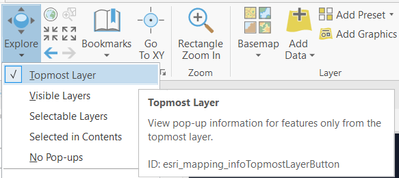

@ElenaMazon does switching the Explore tool to Topmost Layer work for you?
ElenaMazon
It does! sorry about that, I had it set to Visible Layers understanding that the results must show the only image metadata I was visualizing. But I will change my mind about that.
Thank you so much @KoryKramer !
