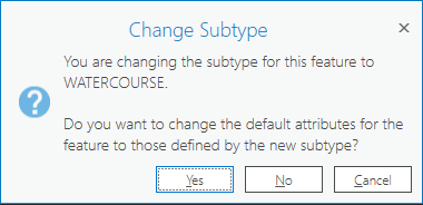

Note: I did get the message/option below. But choosing "Yes" had no effect on the ACTIVITY field, since the ACTIVITY field doesn't have a default value (and we don't want it to have a default value):
Could Pro be enhanced to account for the invalid domain value in that scenario?

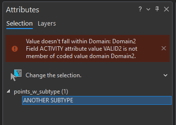

The Attributes Pane will show a warning like this in that scenario:
And prevent the edit if Enforce Validation is checked on in Editing settings: https://pro.arcgis.com/en/pro-app/latest/help/editing/change-general-editing-tool-settings.htm

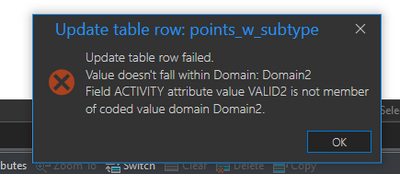

If you are editing in the Attributes Table it also pops up a similar warning once you attempt to move to the next record (to commit the edit):
-Scott
We don't really use the Attributes Pane very often, only the Attribute Window. So I didn't notice that  warning message.
And prevent the edit if Enforce Validation is checked on in Editing settings.
I checked and that setting is enabled.

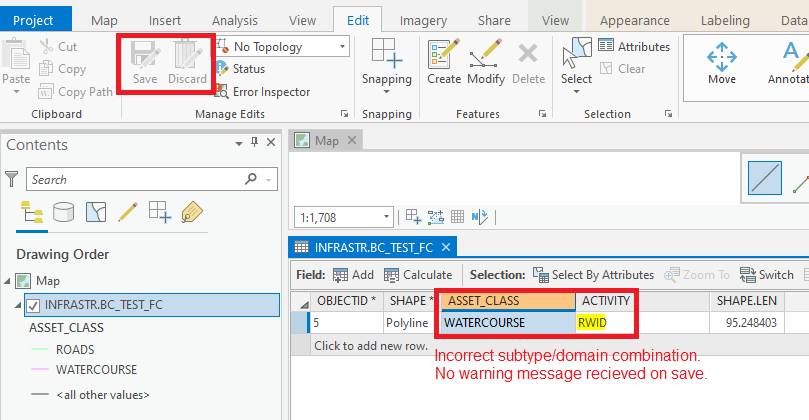

If you are editing in the Attributes Table it also pops up a similar warning once you attempt to move to the next record (to commit the edit).
I'm not seeing that behavior in a non-spatial table in Pro 2.6.8 (Oracle 18c EGDB). Do you know if it was added in a subsequent release of Pro?

Bud
@Bud 2.6 was the release that validation was added for feature classes. 2.8 for standalone tables.
If you are working with a feature class, perhaps you didn't attempt to commit the edit yet by hitting enter or navigating away from the active record?
It's weird, I don't get the warning message in the Attribute Table in 2.6.8, not even when working in a feature class (and saving/committing the record).
I tried with the FC versioned (with base) and non-versioned. No difference.

Scott_Harris
@Bud 2.8 is the first version where I see the error dialog we are talking about being generated from the Attribute Table. So the Map Exploration team must have added it then.

If you are editing in the Attribute Table (starting in 2.8) it also pops up a similar warning once you attempt to move to the next record (to commit the edit):
