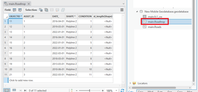

I want to create a new standalone table. When creating the table, I want to import the schema from an existing FC called main.RoadInsp.
main.RoadInsp FC:

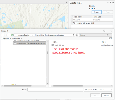

In Create Table, I click Import and browse to the mobile geodatabase.
Problem: I don't see the FC listed, so I can't use it's schema when creating the table.
Could that behavior be changed so that I can use the FC's schema when creating a table?

Thanks for the Idea, @Bud
Currently, users are able to import the schemas from feature classes to standalone tables when the feature classes are stored in file or enterprise geodatabases, just like in ArcMap. Brining this functionality to classes in mobile geodatabases is a worthy idea. I'll make sure it gets to the team.
