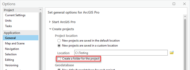

If you prefer to create all your projects in the same location without creating a project home folder for each .aprx file created, you can specify this preference in ArcGIS Pro's backstage, Options dialog, General tab, under Create projects, by specifying the location, and unchecking "Create a folder for the project":

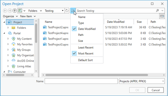

When you want to select an existing project to open, in the Open Project browse dialog box, you can go to the location where you have created a number of your projects, and sort the projects .aprx files by Name, Date Modified, etc.:

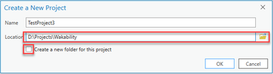

It seems that I misunderstood what you wanted last time.  If you want to put different project .aprx files in different client folders, you can do so by setting the project location in the Create a New Project dialog when you create a new project:
You can select a location that you think the project file should be - you can enter the path directly in the Location textbox or use the browse button to select the location.  Again, you can check or uncheck "Create a new folder for this project" to control whether the project file will be create under a new folder or not in that location.

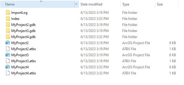

Thank you for your thoughts.  I think my suggestion boils down to this: the only option (now) when creating a new ArcGIS Pro project is to save all ArcGIS Pro project files (*.gdb, *.aprx, \ImportLog, etc) into one folder (either one directory as shown below, or each project into its own folder if "Create a new folder..." option is checked).
I want an options where the *.APRX can be saved into a different location than (*.gdb, \ImportLog, etc).  It's totally possible to SaveAS the *.aprx into another directory than where it was originally create, I just want this option at the start.  Why should I have to litter my folders with all of the (*.gdb,  \ImportLog, etc) for every project, or have all of my *.aprx buried in a million project folders (if "Create a new..." is checked) when the *.aprx is all I need to open ArcGIS Pro?
