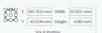

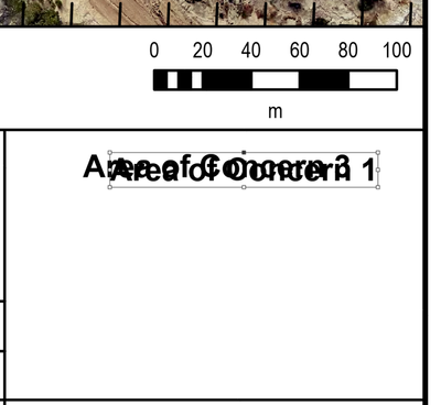

RTPL_AU
Copy from Layout 1:
Paste Layout in copy of project (over other text in correct location to show arbitrary offset):
Offset seems to be linked to zoom level.
Project 2 is a copy saved of project 1 with a different are of focus in the map.

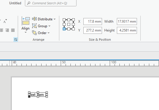

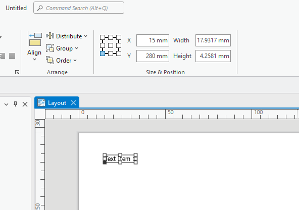

RTPL_AU
Open new Pro-ject without a template.
Insert A4 Layout.
Create Straight text object
Open new Pro instance without template
Insert A4 Layout
Copy text from 1 to 2 (Select with mouse, Ctrl-C, click in Instance 2, Ctrl-V)
Text is in different location.
1:
2:
In this case zoom level didn't make a difference so disregard for now (tested at only 5 zoom levels).
