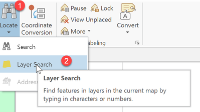

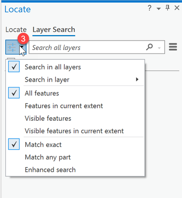

There are options for Locate
Locate_options0.pngLocate_options0.pngAfter you specify a Layer Search you can
click on the drop-down to fine-tune your match.

It looks like Dan pointed to the various options when using the Locate pane.  The Layer search > Search in layer allows you to specify a single layer and a single field if desired.  This might have been better posted as a question first, and if it turned out that what was requested wasn't possible, then moving to search for whether somebody else in the community had the same idea, and finally submitting a new idea if needed.  Here are the ArcGIS Ideas Submission Guidelines and Statuses that cover the basic process.

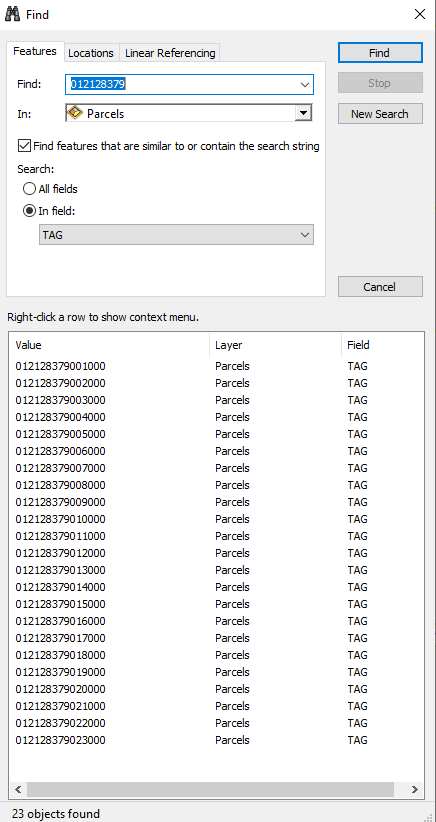

Thank you for the comment here @AileenProfir Can you provide an example of your Find workflow in ArcMap and show how sorting the results helps you? My guess is that differences between the Find dialog in ArcMap and the Locate pane in Pro have architectural differences that would make a 1:1 comparison difficult, but fully understanding how you use sort in your current workflows will be helpful. (Please include screenshots if possible) Thank you!

Hi @KoryKramer
Our TAG field (text) contains 15 digit IDs for one of our county's parcels.  I used the Find tool to search the first 9 digits and then sort so that I can see what numbers have been assigned for the next 3 digits (all of them end with 000).  This same list can be generated with the Locate tool but cannot then be sorted so that I can easily determine, say, the next number that would be assigned - or if any numbers haven't been assigned.

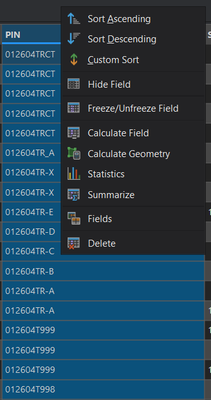

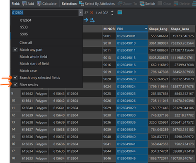

Could you use the Find functionality in tables to achieve the same result?
If I set it to 'search only selected fields' and select the PIN field (yours would be TAG), and to 'Filter results' I can then sort ascending/descending.
AnnabelleStewart1
Yes that works!  Thanks for pointing that option out.
