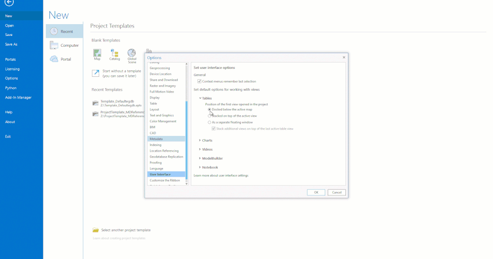

Add an option to place the new table window next to the existing one in a row. I think you call this stacking.
In AGP Options, tables can be docked below the active map, stacked on top of the active view, as a separate floating window.
The "below the active map" option stacks vertically on top of an already open table. While that is below the active map, an option should exist to have it in the same pane area as other tables.

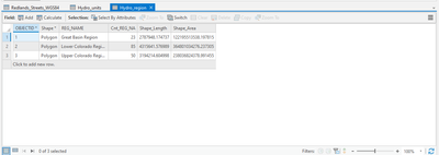

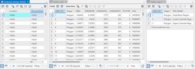

Just to make sure we understand, are you asking to have an option for newly opened tables to open like this:
Instead of this:
Correct?
GabrielMarcus_C
Kory,
No. I would like the second option. Maybe it is a bug instead of designed behavior when one table appears on top of another one?

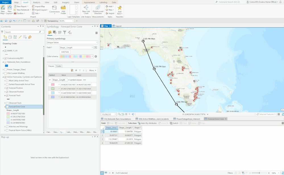

Hmm, I guess that is why I was confused about this idea because what you are asking for, then, is the current behavior.
Here is a quick clip that I just took from 2.8.2:
You may need to work with support to troubleshoot (depending on your User Interface settings).

Ever since this option was added (2.4?), the below clip has been how this feature has operated for me, so I thought that was the expected behavior!
Here's a quick clip I also just took from 2.8.2. I have same option selected as you.
I generally open the attribute table using control double click, but opening the attribute table from the contextual menu produces the same action.
