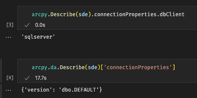

@HannesZiegler Thank you - I do see those entries now in the docs. What threw me for a loop was that it does not get included when using arcpy.da.Describe.
Any ideas on that? Is that a bug?
HannesZiegler
Yea that is an issue, there is an idea for it here: arcpy.da.Describe should return the same data as a... - Esri Community
You can upvote (kudo) it, we keep tabs on ideas (this one is already under consideration)
