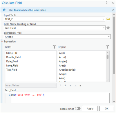

For cases where we would rather use SQL than Python or Arcade:
Could functionality be added so that we can generate a value using a SQL expression -- that would be returned back to the Field Calculator geoprocessing tool?
For example, if I already have a complex SQL CASE expression written from a different use case, I don't want to re-write it in Python or Arcade. I'd rather just use the SQL as-is instead, to save time and avoid mistakes.
I'm aware that it's possible to create a SQL database view, join it to the FC attribute table, and do a field calculation to bring in the joined field value. But that's pretty cumbersome for a one-off calculation. So I'm wondering if we could use the SQL expression directly in a Python or Arcade field calculation instead.
