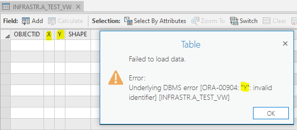

Now, due to changing requirements, I want to remove some fields from the view. I can do that in the SQL Client. However, changing fields will break the registered view. The view will error out in ArcGIS Pro when I open the attribute table:

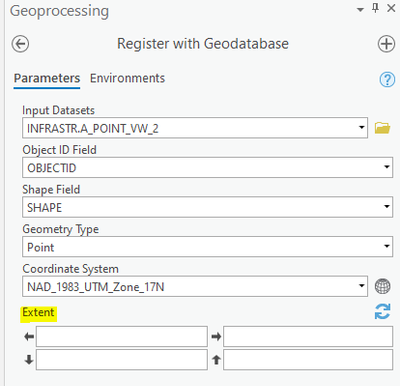

I'm aware that I can manually set the extents when registering with the geodatabase:
That works, but I don't necessarily know what the possible extents of the view will be. So setting the extents initially is just a guess and will likely need updating in the future.
