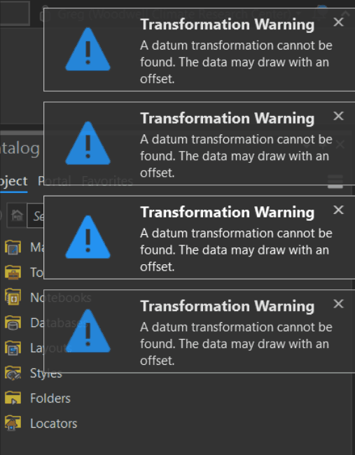

Thank you for investigating, Kory.  I don't think every notification is equal.  The main notification that prompted my request is 'Transformation Warning'.  I have some Pro projects that sit and run through many dozens of these notifications before they become responsive to the user.  I am aware of these transformation issues and I think it would be great if we could silence this type notification.  Ultimately, I'd like the control to choose which type of notifications to see -- if possible.

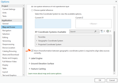

Thanks for the details @GregFiske The transformation warning can be turned off https://pro.arcgis.com/en/pro-app/latest/help/mapping/properties/default-settings-for-new-maps-and-s...
Does that work for your specific situation?

Hi - the checkbox you highlighted appears to be turned off by default.  On or off, it had no effect on my transformation warning notifications.

I see - I read the warning more closely in the .gif that you provided above and it is saying that a transformation cannot be found, rather than that data added to a map has been automatically transformed, which appears to be what the options checkbox controls.  I can pass this along to the development team, but can you share details about the coordinate system of the map and the coordinate system(s) of the data you're adding?

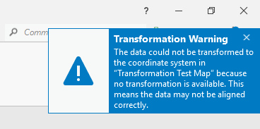

Oh, and one more question, what version of Pro are you using?  I tried with different data for which no transformation is available and got the following message - but it isn't the same as what you're reporting.  So the version of Pro and the map and data coordinate systems would be good to understand.

@KelleeKoenig1 out of curiosity are you getting the multiple, scrolling notifications like @GregFiske is showing in the .gif above from 8-30-21?
KelleeKoenig
Yes, usually about 3-5 notifications.
