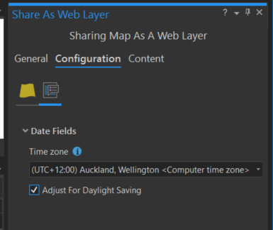

The answer according to several blogs and Geonet posts appeared to be to set a timezone when publishing the feature service. We tried this by publishing a new test service, but it made no difference.

This seemed unusual, since we had specifically set a timezone in Pro before publishing. We tested publishing several more feature services, sometimes specifying a timezone and/or different timezones and with daylight savings ticked/unticked, but every time the JSON says the timezone was UTC and respectsDaylightSaving was false.

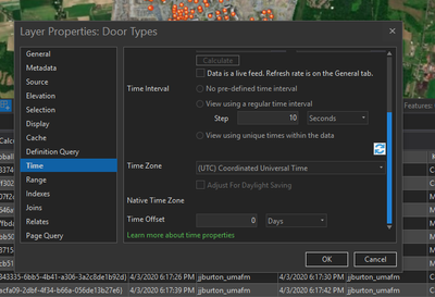

If you open a feature service layer's Property page, switch to the Time tab and scroll down a bit, you will see the Time Zone is set to UTC for that layer.

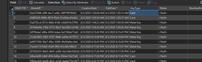

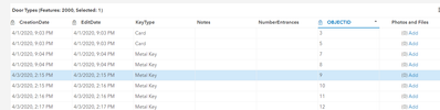

@TanuHoque That is not what I am seeing in 2.6.2
Here is an example feature service in Pro:
Same service in AGOL:
Honestly I don't know which timestamp is correct (aka reflects the time the editor would have seen on his computer's clock when he did the edits). I believe it's probably the AGOL time. It doesn't really matter-- what matters is that they are being displayed differently in AGOL/browser vs Pro.
Its properties show that its time zone is UTC:
TanuHoque
@MTaft-Ferguson
Sorry for the delay, and as it appears I couldn't make it clear.
What you described in your last comment is how Pro behaves. And we realized that creates a lot of confusion.
As I mentioned:
  • ArcGIS Online Feature Services store date/time in UTC
  • Feature Services return date/time in UTC
  • ArcGIS Pro displays date/time values in UTC
  • When you visualize the same feature service in MapViewer (or AGOL) in a web browser, the  date/time values are displayed in your device's local time zone, NOT in UTC.
    • Since  you are in MA, date/time values are displayed in EDT when viewed in AGOL map viewer - which are 4 hours (or 5 depending on day light saving) behind UTC.
  • Since AGOL and Pro are showing date/times in two different time zones you are seeing the discrepancies. It creates confusions, and potentially corrupts data when an editor enters date/time values in local time zone instead of UTC in Pro.
