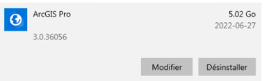

Robert_LeClair told me to remove the update package but I can't find where to remove the package to return to 3,0.  In Pro, doesn't find a remove update and in window software pane, just one entry.

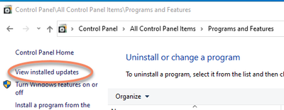

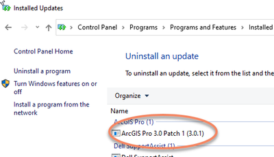

to get to the patch:
open control panel -
click start and then type control panel > click enter
on the control panel click Programs and Features
on the dialog that opens, click View installed updates
you'll see the patch there and can uninstall it
