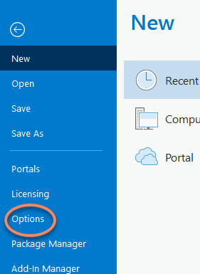

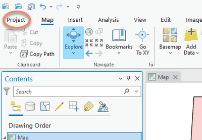

how are your backstage options set?  to get there, go to the Project tab and then click Options

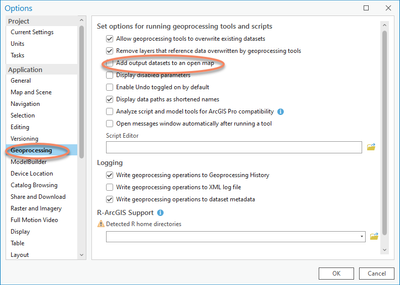

on the Options dialog box, click Geoprocessing and then uncheck the Add output datasets to an open map
now test running the tiled labels to annotation gp tool.  do the labels stay on?

Hum, that is not what I'm referring to.  Adding the generated annotation to a map work as it supposed to do.  Nice feature to have by the way.  Better could be to classify in the FGDB for further use instead of choosing manually.  But not the topic now.
The problem is elsewhere like told before.  In arcmap, converting label to annotation automatically remove the flag to label the feature.  When using geoprocessing, the flag still in labeling mode so we can do it again and again without having to flag for labeling again.  In Pro,  the conversion is the same as in arcmap, the labeling flag is out, that's ok.  But, when using geoprocessing, all the labeling flag are out.  We have to manually redo the flag.
