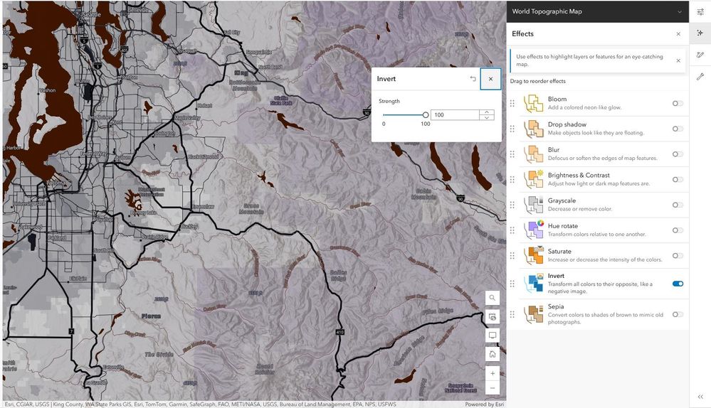

A workaround is using the invert option under the effects settings for rasters loaded into your map. If you want it for a basemap, simply add the basemap as a layer and apply the invert effect and just have the layer turned off in the TOC. When it's needed, simply turn it on.
Here's the World Topo Basemap inverted:
