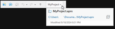

The new (3.4) ability to copy the APRX path in the taskbar is pretty great.
I'd like to be able to copy and/or open the location of the project, as well.
1 Comment
NaicongLi
Hello @AlfredBaldenweck ,
Thank you for your suggestion!  What you were asking for is already offered in ArcGIS Pro.  In your screenshot above, if you click the project .aprx file link, a File Explorer window will open at the location of the project file.  This is documented here: https://pro.arcgis.com/en/pro-app/latest/help/projects/open-a-project.htm.

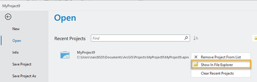

You can also do this in backstage, Info tab:
Another way to do it is to right click the project of interest in the Recent Projects list, and then click Show In File Explorer in the context menu:
