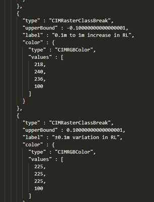

For anyone looking for a workaround until this Idea gets properly implemented.
Save the symbolised layer as a .lyrx
Edit the lyrx in something like Notepad++ (it's just a text file with a loose xml format).
Pull the new symbology back into Pro.
You can change increments, labels, and colours easily:

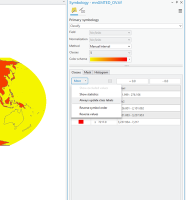

@RTPL_AU You are correct that I mistakenly marked this as fully implemented in ArcGIS Pro 3.4. This was implemented for feature layers in ArcGIS Pro 3.4. From your example, it looks like you are working with raster layers. This has been implemented for raster layers in ArcGIS Pro 3.5, which is to be released soon.
Starting at version 3.4, when working with feature layers, in the More menu, uncheck Always update class labels to get this behavior:
Starting at version 3.5, when working with raster layers, in the More menu, uncheck Always update class labels to get this behavior:
