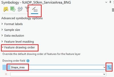

DuncanHornby
This idea is obsolete as this can be very easily done in ArcPro 3.7
Symbolise your layer with a graduated colour then in the symbology panel  go to the advance option. Choose your field in feature drawing order that will sort features and then choose up or down.
