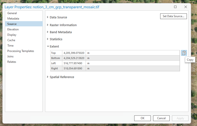

The Properties dialog for layers includes a Copy for the Extent:
What ends up on the clipboard is:
Top 4,205,399.075020 m
Bottom 4,204,529.213820 m
Left 516,777.957490 m
Right 518,054.691890 m

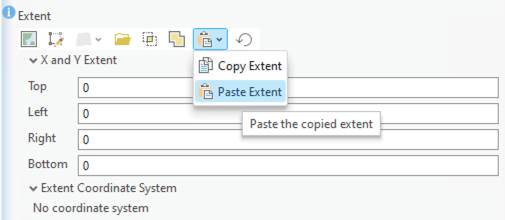

Unfortunately, this does not appear to be the format expected when using Paste Extent in a geoprocessing tool. Attempting to paste the above sets all the values to 0:

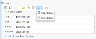

When I manually enter the correct values, and then Copy Extent:
The results on the clipboard use a different format:
516777.95749 518054.69189 4204529.21382 4205399.07502 PROJCS["WGS_1984_UTM_Zone_35N",GEOGCS["GCS_WGS_1984",DATUM["D_WGS_1984",SPHEROID["WGS_1984",6378137.0,298.257223563]],PRIMEM["Greenwich",0.0],UNIT["Degree",0.0174532925199433]],PROJECTION["Transverse_Mercator"],PARAMETER["False_Easting",500000.0],PARAMETER["False_Northing",0.0],PARAMETER["Central_Meridian",27.0],PARAMETER["Scale_Factor",0.9996],PARAMETER["Latitude_Of_Origin",0.0],UNIT["Meter",1.0]]
