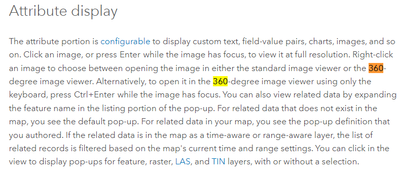

Thank you for posting this idea @RobertGraham1  ArcGIS Pro 2.7 supports 360-degree images so I'm marking this already offered for Pro.
https://pro.arcgis.com/en/pro-app/latest/get-started/whats-new-in-arcgis-pro.htm
There is an open idea for ArcGIS Online here:https://community.esri.com/t5/arcgis-online-ideas/360-spherical-image-support-for-feature-attachment...  You can visit that to provide your support.

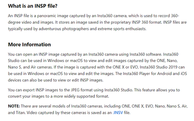

We have a 360 camera we have been testing.  it gives us an .insp

Thanks for the response. But I was hoping to find a help document on how to get them from the camera into Pro
Pro does not recognize the .insp file

Hi Robert,
The .insp file type is not currently supported. https://fileinfo.com/extension/insp
It sounds like this is a proprietary format, but using Insta360 Studio you could export .insp images to JPEG.
You could submit an idea for ArcGIS Pro to support the .insp format. The team could then assess the feasibility, of course depending on what api's may be available from Insta360 to work with the files.
