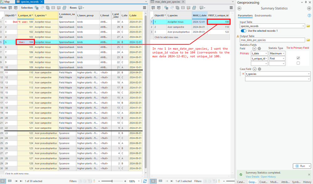

Using a FGDB table, I want to use the Summary Statistics tool to get the greatest 1 per group (no duplicates). And I want to include all the other original fields from the table in the result.
See: Selecting the most recent records based on unique values in another field
If I understand correctly, I can't do that in a single step using the Summary Statistics tool.
I tried to mock up what I want to do in this screenshot:
In the Summary Statistcs fields section, I want to treat the t_date | Maximum field as the primary field. And I want to tie subsequent fields like t_unique_id | First to that primary field. So that I get the t_unique_id value that corresponds to the t_date | Maximum, not the first t_unique_id for the entire species group.

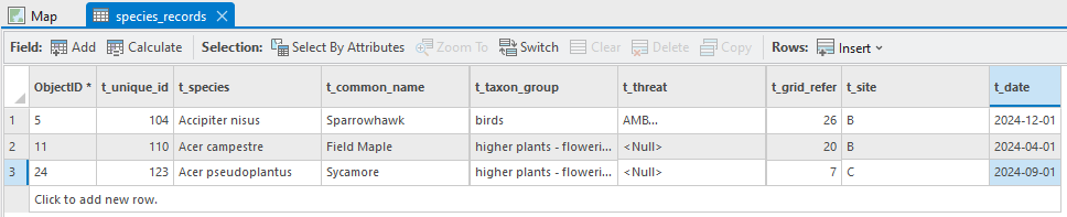

The result would look like this:
