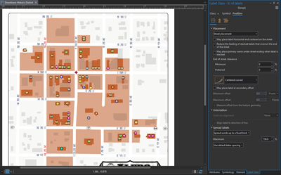

I've messed with all the bells and whistles I can find, but I cannot find a way to get my street labels to stick to non-intersecting segments. Pro is aligning labels with each other from street-to-street which is very nice, but this causes issues in areas where those alignment lines intersect - ex. W 2nd Ave isn't labeling at all. I hate to have to convert to graphics or annotation for something so small. A parameter to keep labels off intersections (whether there are planarized vertices or not) would be fantastic; bonus points if the user can set the lines of alignment. In cities with a quadrant or other directional system, this would come in handy for aligning to the origin or other desired path.

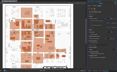

If I set them to repeat, they get off each other, but then there's no sense of alignment anymore. The placement becomes very random depending on the value I set there (and it doesn't actually repeat since I want all duplicates removed anyway)
The help at Label using the Street placement style—ArcGIS Pro | Documentation simply states that "When labeling streets, the Maplex Label Engine places labels to avoid street junctions," but this isn't happening; further, modifying the 'End of street clearance' parameters suggested by the help to "avoid placing labels in or near street junctions" does not change their placement.
