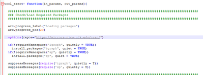

I just add a small issue when running it. At first it complained that it could not load a library from an R CRAN repo which in the meantime has closed (http://cran.cnr.berkeley.edu/bin/windows/base/) so I hardcoded the CRAN repo manually in state_tree_graph.R:
options(repos="url_of_the_cran_repo")
I know nothing about R and did not know where the default repo config is located.

ErikLash_HiCo
To overcome the Berkeley mirror restriction:
  1. go to the CRAN Mirrors site https://cran.r-project.org/mirrors.html and copy the URL for the mirror of your choosing.
  2. Open state_tree_graph.R (included in the toolbox files folder) in your favorite editor.
  3. Insert the line of code: options(repos="url_of_the_cran_repo")
  4. Save the state_tree_graph.R file.
  5. Run the toolbox in ArcGIS pro.
