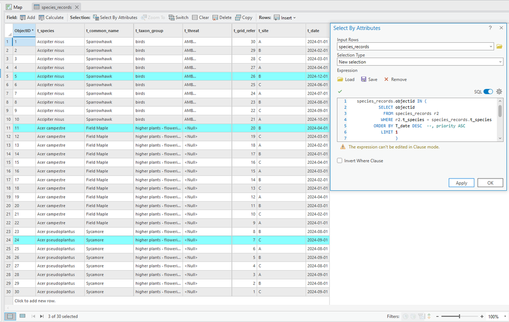

A common scenario in Select By Attributes or in a definition query is to: Select the greatest 1 row per group, no ties.
For example, for each species group, get the row with the latest date. If there are multiple rows per species with the same date, only get one row (arbitrarily).
That can be done in a mobile geodatabase using the LIMIT clause:
species_records.objectid IN (
         SELECT objectid
           FROM species_records r2
          WHERE r2.t_species = species_records.t_species
       ORDER BY T_date DESC  --, priority ASC
          LIMIT 1
And it can be done in Oracle using the FETCH clause:
         SELECT objectid
           FROM species_records s2
          WHERE s2.t_species = species_records.t_species
       ORDER BY t_date DESC --, priority ASC
          FETCH FIRST ROW ONLY
But it doesn't seem to be possible in FGDB SQL. Could the LIMIT clause be added to FGDB SQL?
I've attached sample Excel data that can be loaded into a file geodatabase.
