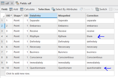

@JoelBurley Maybe this can help with common words, but rare words may need some extra attention (As shown in the below example).
arcpy.management.CalculateField(
    in_table="sdf",
    field="Correction",
    expression="spell_check(!Misspelled!)",
    expression_type="PYTHON3",
    code_block="""from spellchecker import SpellChecker
spell = SpellChecker(language='en')
def spell_check(text):
    return spell.correction(text)""",
    field_type="TEXT",
    enforce_domains="NO_ENFORCE_DOMAINS"
JoelBurley
Thanks @JonathanNeal ! I will have to give that a try.
