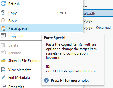

Hi @Bud You can control the output name of the pasted feature class by using Paste Special. See https://pro.arcgis.com/en/pro-app/latest/help/data/geodatabases/overview/copy-feature-datasets-class...

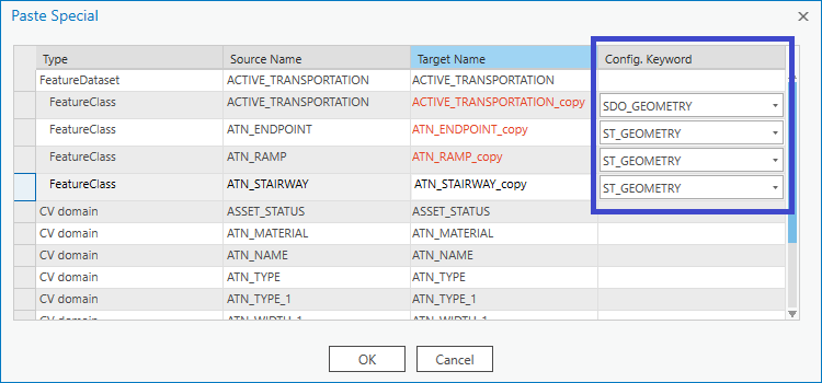

@KoryKramer Thanks. I didn't know about the Paste Special functionality.
It looks like Paste Special also lets us specify the spatial type too — via the "Config. Keyword" picklist:
So I think you can change the status for this entire idea (both for renaming and spatial types) to "Functionality already exists".
