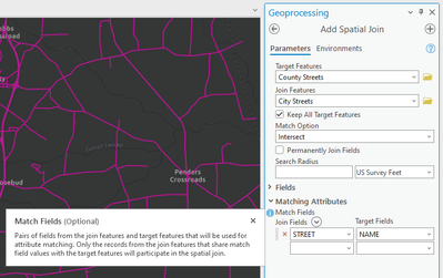

The ArcGIS Pro 3.2 release will have a new Match Fields parameter on the Spatial Join and Add Spatial Join tools that can be used to accomplish what is described in this issue. When looking at set of join features that match the desired spatial relationship to a target feature, the match field values will be evaluated to see if they are the same. If the match field values are the same, the spatial join will be made. If the match field values are not the same, those join features will be excluded from the spatial join.
MargaretCrawford
Status changed to: Implemented
This Idea has been implemented in ArcGIS Pro 3.2. Please check out this blog to learn more about how to use the new Matching Attributes parameter in Spatial Join & Add Spatial Join.
